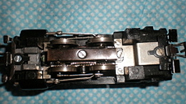

allego qui sotto la foto di una macchina assolutamente perfetta, e dunque di riferimento.
Si vedono gli ingranaggi dal lato delle spazzole e le quattro viti di fissaggio. E' possibile che il modello proposto da e-bay abbia subito montaggi e smontaggi e che in uno di questi sia stato montato il carrello motore dx-sx invertite, dato che le spazzole stanno sotto la cassa della locomotiva.
Non può essere invece un dx-sx della foto, come testimoniato dalle scritte

dal catalogo ricambi 1960 ricavo anche il disegno del gruppo carrello/motore della B&O; sembra che non sia invertibile, data la differenza dei supporti fori per le viti

I have three of these B&O Locomotives and all have the brush gear on the right side. It does appear that the motor unit has been dismantled and reassembled incorrectly. This is very easy to do with the dc version of this model, as there are no wire connections to lights or other ancillary systems. What was again interesting was that the inner connecting rods were missing. It is my conclusion on this issue as previously discussed that the “Green Series” sold with three wagons as a set, did not have the main wheel connected. This locomotive must have been originally in a set and subsequently sold on singly. It is possible also that the motor gearing was different to that of the later models to slow the Locomotive down. It was difficult to determine from the eBay photo whether the gears were course or fine type. I have both types of motors in my possession and did not realise there was any difference until I received a spare motor from Giorgio Tanzi. This took me by surprise as I thought that the motors for the B&O Locomotive could be exchanged for those on the E626, with the different wheels of course. Please see attachment showing the different sprockets used. Also see Rivarossi 1949 catalogue pages 9&10 showing brush gear on left and right hand side, although this may have been photographic licence for cataloguing purposes, who knows?
Additionally see an underside photo of one of my B&O Locomotives
Regards Howard

Underside of one of my B&O Locomotives

Thank you Dodi for your quick response. Yes, if I was sitting in the Locomotive cab, as the Engineer (Driver in the UK) the brush gear would be on the Left Hand side. Sorry for the confusion hope this clarifies the matter. I don't know whether my observations are pertinent, however I have always been intrigued by these early spur gear motors. I have actually calculated the ratios for both types of motors in order to measure the speed relationship, however I shall keep that for another day.
