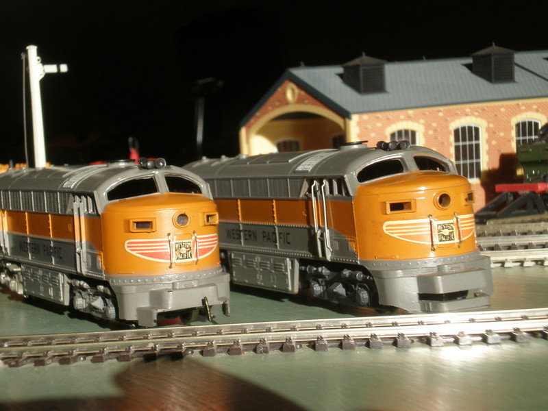

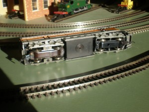

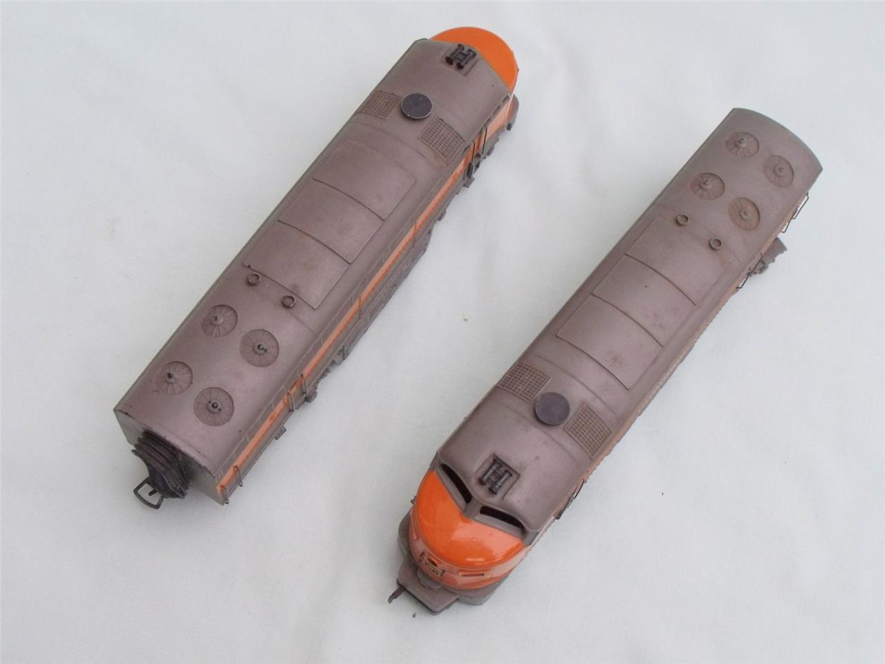

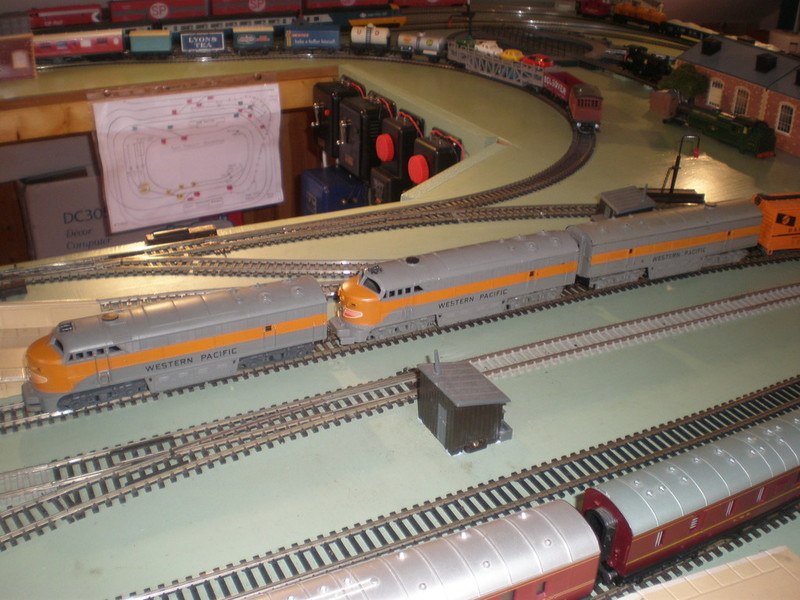

Hi Gianni, Can you tell why there are two types of body shells for the Fairbanks Morse American Diesel Locomotive. I have just been lucky to purchase another Western Pacific model and it is in very good condition and has not seen much service. It appears to be an early version as the motor has the screw type brush gear. When I examined the gear box it did not appear to have ever been lubricated as the gearing was dry and totally devoid of grease. I think the model has been in a show case in someone's collection. The motor ran perfectly well and even better after receiving the oiling treatment. I have attached some pictures which show the body shell differences. This latest version appears to have more embellishments ie handrails and the front has a better finished "snout" Best Regards Howard

Hello Howard, I try to answer.
The version with the front central slot for the hook is the oldest. In 1957 for the large supply to Lionel has been simplified by removing the cut for the hook. Since the body shell was of this type

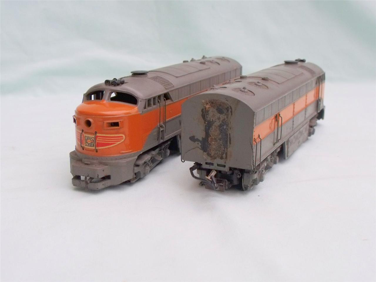

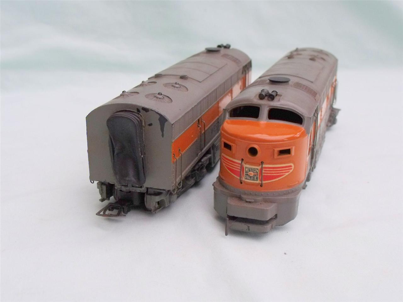

Please can you tell me if this F M combination is made from bakelite or polystyrene plastic.
Howard

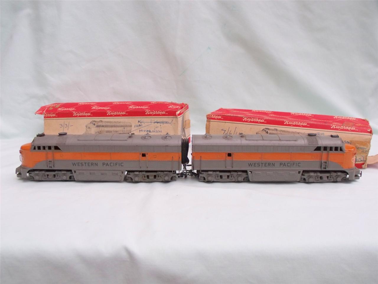

Dear Howard,
both units in your FM WP combo are definitely from 1956, and should feature polistyrene bodies and truck side panels, stamped side lettering and early type motor (with screw-in brush caps). This because the pictures show the rear walls incorporating a small extension (just below the door) with two small slots where the metal bottom (frame) engages.
Early (1952-55) FMs used bakelite bodies, frames connected to the body by 6 screws, metal truck side panels and decals (trasfers) for lettering.
In 1957, instead, the 1956 body moulding was modified with open nose (for NMRA coupler), more detailed rear wall and door and moulded-in side grab irons - however it retained the 1956 mould number, 305. The 1956 frame was mantained, now equipped with the new motor (brushes held by hairpin springs) to be superseded sometime during the year (1957) by the plastic "tub" frame which went on to the end.
To identify any FM example you come across I suggest to refer to the table below. As you can see, the FM in 20 yrs production shared 5 body (carrozzerie) and 3 frame (telai) types only. I don't expect you'll meet too many problems with translation (numbers don't need it!) - don't esitate to ask otherwise.

Messaggioda Nukem001 » 5 nov 2012, 22:20
Dodi, Thank you for your detailed response. As you see from my previous post I have the two types you mentioned ie 1956-1957. I thought that the "closed nose type" were all made in bakelite and did not realise an almost identical model of the 1952 series was made later in polystyrene plastic. The reason I asked this question is because the later pictures shown are from the UK eBay and of course unless you know the full details it is difficult to make a judgement from photo's. I would love the bakelite version so I will continue looking now for the indicators.
